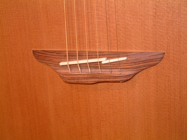

PostPosted: Thu Jun 08, 2006 9:37 pm
I use the method that Michael describes too, here's a picture.
PostPosted: Thu Jun 08, 2006 10:23 pm
[QUOTE=Arnt] I use the method that Michael describes too, here's a picture.
Arnt,
Lovely work on that saddle shaping
The B (2nd) string appears to be right on the back edge of the saddle . How do you find that the saddle wears under this string compared with the other strings?

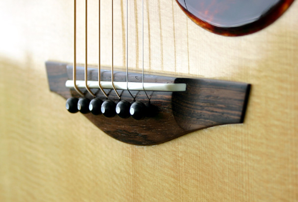

The thing I like about the split saddle is thet I can get each string intonated pretty much along the centre of each saddle:
PostPosted: Thu Jun 08, 2006 11:09 pm
Dave, it looks fragile, doesn't it? However, the saddle is holding up well, no excessive wear (this is my own guitar, almost a year old, so we shall see...). I think what matters is the angle of the bevel, how sharp the edge is and the quality of the material, not so much wheter the location of the "break point" is in the front, back or middle of the saddle.
